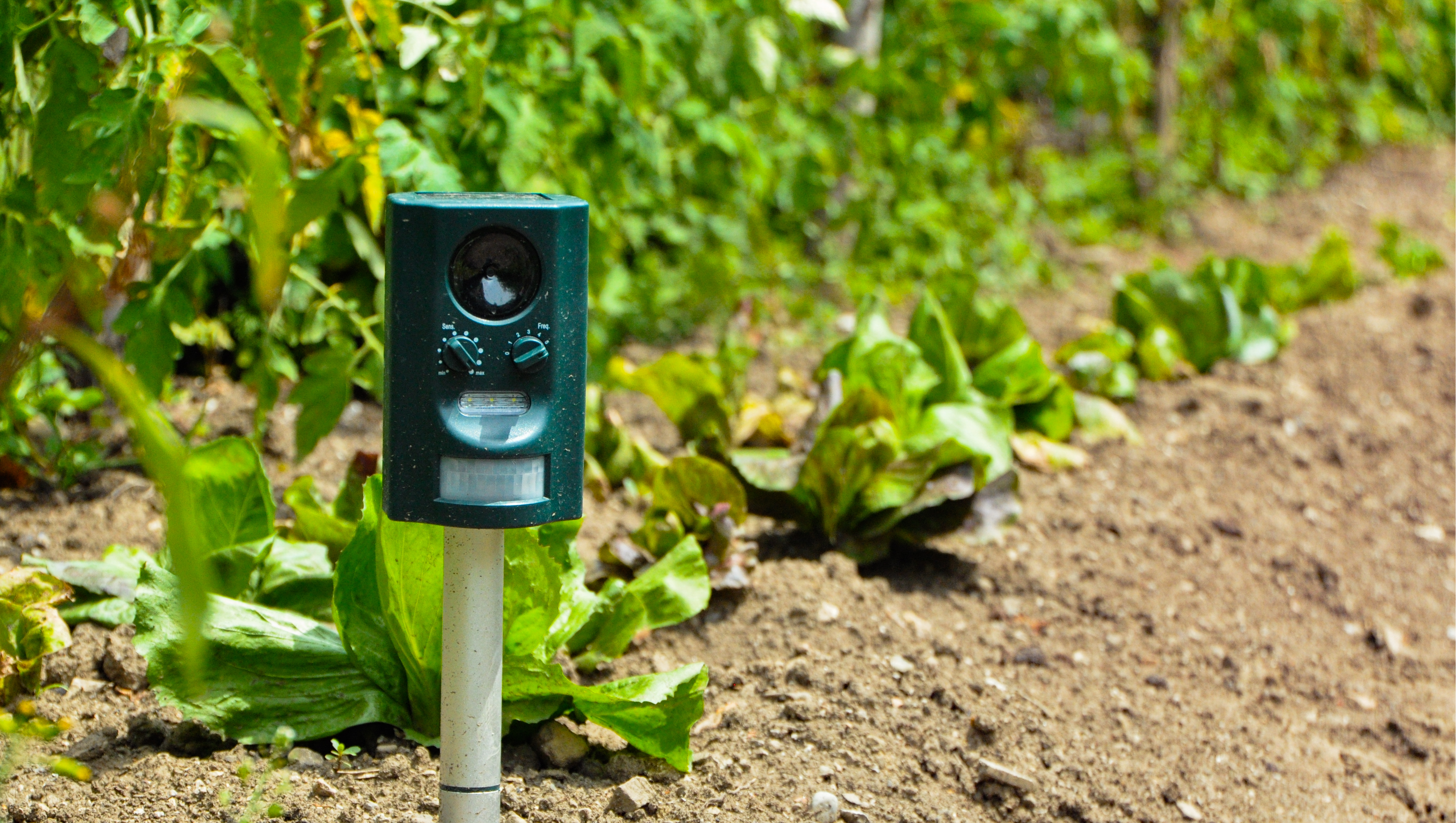

Device density
In addition, LoRaWAN has the ability to connect a large number of devices to a single network so dense deployments such as soil sensors in agriculture can be supported. The architecture features end devices, gateways, network and application servers to provide a scalable, flexible and cost-effective network for IoT. Importantly, a single LoRaWAN gateway can communicate with multiple nodes across large areas and thereby reduce the number of gateways required, bringing down the overall costs of a deployment. Further extension of the capacity and range of LoRaWAN has been added recently with the introduction of relay devices which augment end nodes and gateways to enhance performance.

The long range, high device density, low power consumption, and cost efficiency of LoRa demands similarly specified LoRa modules to ensure devices can be designed to fit IoT use cases. For example, a LoRa soil sensor needs a LoRa module that is cost-effective enough to be deployed in high volumes across farm fields, compact enough to fit in typical sensor probe devices, sufficiently low power for the sensor to remain in operation for months and, of course, able to communicate with a gateway and/or nodes to ensure data is communicated as required, without interruption.
